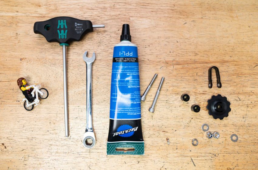

Installing New Pulley Parts​
For GSD Gen 1 S10 and S00​
  1. 45mm bolt
  2. 12mm washer
  3. Guide wheel with u-clip installed over
  4. 10mm bushing
  5. Slide onto the frame and add grease
    2. 12mm washer
  6. M6 stainless steel nut tightened down
  7. 1/4 inch spring washer
  8. M6 locknut tightened down
For GSD Gen 2 S10​
  1. 55mm bolt
  2. 12mm washer
  3. Slide on to frame
  4. 10mm bushing x2
  5. Guide wheel with u-clip installed over
  6. 12 mm washer
    • Grease
  7. M6 stainless steel nut tightened down
  8. 1/4 inch spring washer
  9. M6 locknut tightened down
