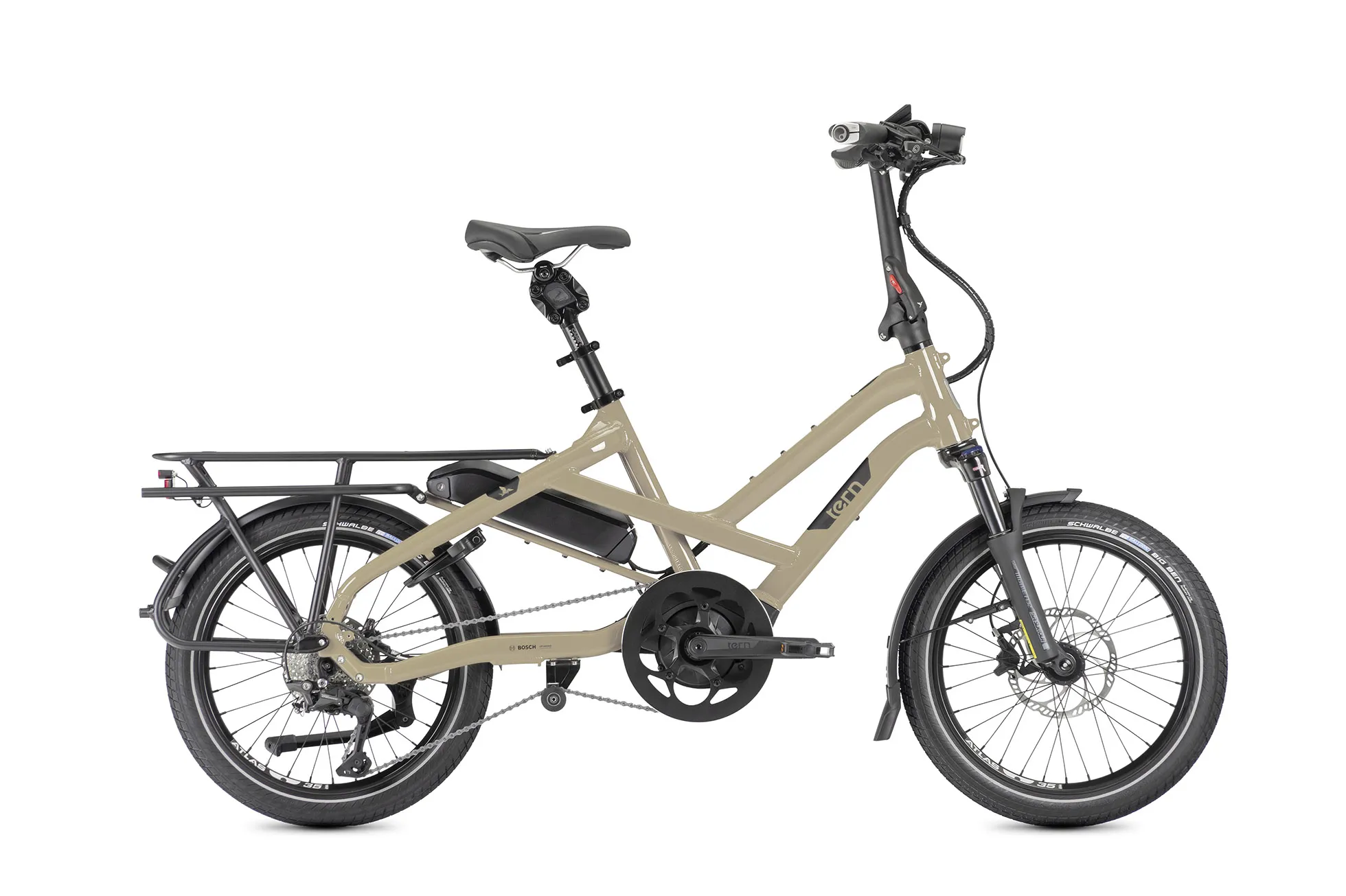

Tern HSD Gen 2 S11 Parts List
Frame & Fork
Frame – Tern HSD, 6061-AL, patented design, Tern sliding dropouts, EFBE Tri-Test approved: 180 kg
Fork – Suntour custom for Tern, 1.5" tapered Chromoly steerer, 32 mm stanchions, Thru-axle, 70 mm travel, EFBE approved: 180 kg
Cockpit
Grips – Standard
Headset – Tern 1-1/8" to 1.5" Tapered, Angular Contact Bearings (SKU: A.02010.0024.00.00)
Saddle – Tern HSD/NBD, Black/Grey (SKU: A.02013.0078.03.00)
Seatpost (Lower) – Tern Telescopic, 34.9 x 285 mm, Black (SKU: A.02014.0051.03.00)
Seatpost (Upper) – Cane Creek Thudbuster G4, 30.9 x 375 mm
Seatpost Clamp – 34.9 mm Lower Clamp, ID 37–38.1 mm (SKUs: A.02015.0023.03.01 & A.02015.0021.03.01)
Brakes
Front Brake – Magura MT4N-e, 3-Finger Lever w/ Switch, Higo Mini B Plug, 950 mm Cable, 1150 mm Housing, PM160–180 Adapter
Rear Brake – Magura MT4N-e, 3-Finger Lever w/ Switch, Higo Mini B Plug, 950 mm Cable, 2100 mm Housing, 1800 mm Assembly
Rotor Front – Magura, 180 mm, 6-bolt
Rotor Rear – Magura, 160 mm, 6-bolt
Wheels
Front Wheel – 20", Disc, 406x32H, 15x100 mm, Black (SKU: F.01002.0095.03.00)
Rear Wheel – 20", Disc, 406x32H, 135 mm, Black (SKU: F.01003.0137.03.00)
Rim – 20"x32H, Doublewall Aluminum, Black (SKU: A.03006.0197.03.14)
Cassette Body – HG, 11-Speed, Novatec (SKU: F.03002.0003.00.00)
Tires – Schwalbe Big Ben RaceGuard, 20x2.15, Wire Bead
Spokes Front (Drive) – 175 mm, 14G, x16
Spokes Front (Non-Drive) – 173 mm, 14G, x16
Spokes Rear (Drive) – 173 mm, 14G, x16
Spokes Rear (Non-Drive) – 176 mm, 14G, x16
Nipples – 14 mm, 14G
Transmission
Crank Arms – Bosch V3, 170 mm, Black (SKU: A.04011.0008.00.00)
Chainring (w/ Guard) – Bosch V3, 56T, No Crank Arm (SKU: A.04010.0014.00.00)
Chainring – 56T, EM20E, M8*5.5L, No Spider (SKU: F.04010.0010.03.00)
Chain – KMC e11S, 11-Speed, 144 Link
Cassette – SunRace MS8, 11-Speed, 11-36T
Chain Guide Pulley – HSD / Quick Haul (SKUs: F.07004.0017.00.00 & A.07004.0050.03.00)
Chainguard – HSD Gen 2, w/ Bracket + Hardware, Black (SKU: F.02031.0101.03.00)
Rear Derailleur – Shimano DEORE XT RD-M5120 SGS, 10/11-Speed, Direct Attachment
Shifter – Shimano DEORE XT SL-M5100-R, 11-Speed, 2400 mm Cable
Pedals – Standard
Misc
Speed Sensor Cable – Bosch, 815 mm (SKU: EB11.200.012)
Battery Lock – ABUS T82 style key, Keyed-Alike with frame lock but not compatible with keyed alike program
Frame Lock – ABUS 4650L, Keyed-Alike with Bosch Battery
Light Bracket – Ignis, Handlebar Mount (SKU: F.07004.0026.03.00)
Dropout (Derailleur) – HSD Gen 2, Left/Right (SKU: F.07004.0032.03.00)
E-Wiring (Rear) – Higo 2T2 Adapter Cable (SKU: A.06005.0029.00.00)
E-Wiring (Front) – Higo 3T1 Adapter Cable (SKU: A.06005.0027.00.00)
Fenders (SKS) – 20", Front + Rear, w/ Hardware, Matte Black (SKU: F.05002.0017.03.00)
Kickstand – Ursus Mooi, 225 mm, Black (SKU: F.02017.0016.03.00)
Light Wiring (Brake Signal) – Higo Y-Cable (SKU: A.06005.0028.00.00)
Light Wiring (Power Source) – Bosch BES3 Source Cable (SKU: A.05005.0044.00.00)
Front Light – Ignis Z3EK Pro, rev2022 (SKU: F.05005.0003.03.00)
Light Remote – RB5 Remote Button, Magura Clamp, for Ignis Light (SKU: F.05005.0004.03.00)
Rack Plug – GSD, HSD, NBD, Vektron (SKU: A.02009.0009.03.00)
Rear Light – R3EK, w/ M4 Bolt + Washer, rev2022 (SKU: A.05005.0043.00.00)
Rear Rack – HSD Gen 2, w/ Hardware, Matte Black (SKU: A.05004.0077.03.12)
