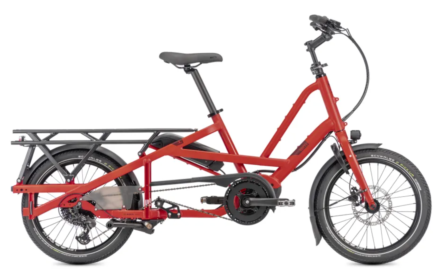

Tern Quick Haul Long Parts List
Frame & Fork
Frame – Tern Quick Haul Long, Patented Design, 6061-AL, DIN 79010 certified: 190 kg (419 lb)
Fork – Cargo, Aluminum alloy, DIN 79010 certified: 190 kg (419 lb)
Cockpit
Handlebar – Low Riser Ergo, Ø 31.8 x 680 mm (A.02006.0048.03.04)
Headset – Cartridge Bearings, 1-1/8", Black (A.02010.0031.00.00)
Stem – Speedlifter Classic, 1-1/8" T15 (A.02007.0039.03.00)
Seatpost – 34.9 x 450 mm
Seatpost Clamp – 34.9 mm, Lower, ID 37 mm, Black
Brakes
Front Brake – Tektro HD-T280, 900 mm cable w/ A3 Adapter
Rear Brake – Tektro HD-T280, 1800 mm cable w/ A4 Adapter
Rotors – Tektro 180 mm, 6-Bolt (Front: TR180-24 F, Rear: TR180-24 R)
Wheels
Cassette Body – 9-Speed, Quick Haul Long (F.03002.0014.00.00)
Front Wheel – 20", 32H, 100 mm (F.01002.0097.03.00)
Rear Wheel - 20", 32H, 148 mm (F.01003.0142.03.00)
Spokes (Front) – Drive: 174 mm, Non-Drive: 173 mm, 14G
Spokes (Rear) – Drive: 174 mm, Non-Drive: 176 mm, 14G
Nipples – 14 mm, 14G
Tires – Schwalbe Pick-up Perf, 60-406, Addix E
QR Skewer – Front Hub, 115 mm
Drivetrain
Chainring – 48T (F.04010.0014.03.00)
Crank Arms – 170 mm (A.04011.0013.03.04)
Chain – KMC e9S, 9-Speed, 170 Links
Rear Cassette – Tektro CS-M352-9, 9-Speed, 11-42T
Rear Derailleur – Tektro RD-T350-S, 9-Speed, Short Cage
Shifter – Tektro SL-M350-9R, 9-Speed, 2600 mm cable
Rear Derailleur Hanger – Silver (F.00002.0068.04.00)
Pedals – Standard
Chain Guard – 46/48T, Extension (F.02031.0103.03.00)
Chain Guard Plate – Quick Haul Long (F.07004.0038.00.00)
Chain Stay Protector – Quick Haul Long (A.05009.0041.00.00)
Chain Guide Bracket – Gen 2 (A.07004.0108.00.00)
Chain Guide Pulley – Gen 2 (F.07004.0027.00.00)
Pulley Wheel (U-Guide) – (A.07004.0094.03.00)
Bells & Whistles
Rear Rack – Atlas L, w/ Hardware (F.05004.0010.03.12)
Kickstand – Atlas Kickstand Gen 2 (F.02017.0024.03.00)
Kickstand Damper – POM, OD 18 x 6 mm (F.07003.0005.03.00)
Front Light – Projector Beam (F.05005.0009.03.00)
Light Bracket (Front) – Quick Haul Long (F.07004.0039.03.00)
Bosch Light Cable (Front) – 1400 mm (1270.020.322)
Bosch Light Cable (Rear) – 1400 mm (1270.020.324)
Speed Sensor Cable – Bosch, 800 mm (1270.020.806)
Frame Support – For Vertical Parking (F.07004.0013.03.00)
Scuff Guard – Matte (A.02027.0009.00.00)
Rack Plug – GSD, HSD, NBD, Vektron (A.02009.0009.03.00)
Mudguards – 20", F&R w/ Hardware (F.05002.0019.03.00)
