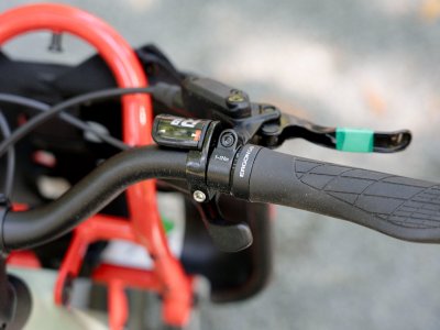

A few years ago, Woom Kids Bikes switched to using microSHIFT twist shifters on many of their bikes. This may have been to save money or during the COVID boom when many shifting parts were completely unavailable. Either way, the microSHIFT twist shifter on many of their bikes can be hard to turn, especially for a kid. Let’s go through the steps I’ve taken on multiple woom bikes to fix the hard-shifting.
Parts Needed to Fix the Problem​
microSHIFT Trigger shifter – I’ve used the Mezzo
A New Right Hand Grip – Woom will send you one, but I ordered basic bolt-on grips when I ordered the shifter
Replacing the Shifter​
If you’ve never replaced a derailleur cable on a bike, this may be one to leave up to a bike shop. But if your bike is new, this is a great opportunity for you to learn some bike maintenance. Note that the video below shows how to replace the cable. The new shifter has the cable already installed, so you won’t need to put a new one in, and you can start around 8:16 in the video.

Do you have the video for this? I have exactly this issue with the Woom 4 - way too hard for my kid to change gears.
No video. Following the directions of replacing a derailleur cable should get you setup.
