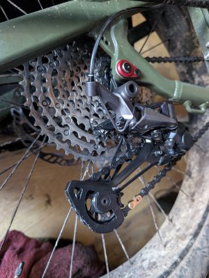

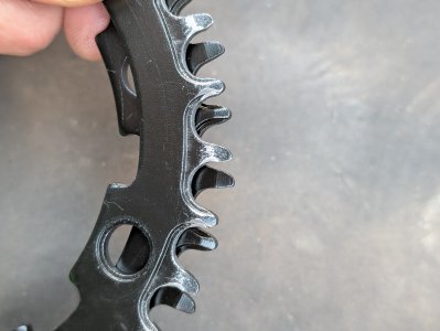

I think I've cooked my cassette on my s12 Orox.
Ever since changing the chain that was far too worn, the gears are noisy under load and it's skipping in 11th and 12th gear. I indexed and reindexed the gears and adjusted the B-screw but no change. Weirdly the gears are louder when going up gears than when going down gears
this initially made me think it's the cable sticking but after watching the derailleur working it looks like the chain is climbing the teeth.
So my question is, can you think of anything else? But mainly what's the difference between XT cassettes and deore cassettes. Is it just weight or is there a more important difference?
