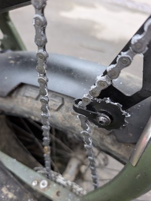

Which wax did you go with as it looks very flaky, or at least more flaky then the wax I use (Rex). You expect some sloughing off at first, but that looks like a bit more than usual.
This can also happen if you allow the wax to cool a bit too much before pulling the chain out, or if you don't allow the chain to fully drip. I wouldn't be overly concerned as long as the wax was at one point hot enough to penetrate the links fully.
It's enigma black edition, I could find REX easily available here. It says to pull the chain at 60° which is really thick so I wonder if it's just more excess wax? Either way I did 30km yesterday and now looks perfect.
We shall see.
That's what I'm thinking. The directions for this is to leat to 120°c turn off the pot and pull at 60°c so it's really quiet thick.
AHH, I was looking too far down I think. 👍
This might be why I see less 'flakeyness' on my waxing as I pull it out around 80C and hang the chain up to dry/cool where it doesn't drip much, but it's not overly coated with wax. There's no downside to a waxed chain that I've found, even if I'm doing it wrong. :D You seem to go hard so I look forward to see what your experience with is like.
